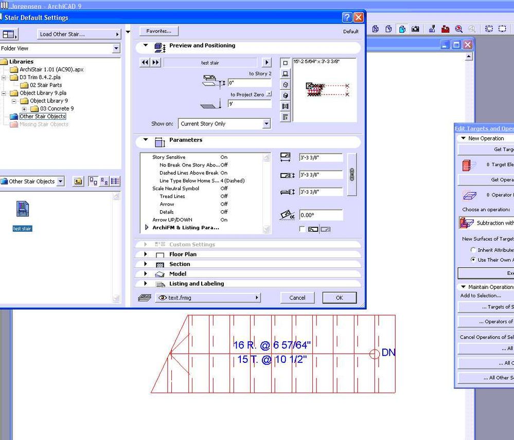

Erika Epstein
In the stair settings tool box have the
"Arrow UP/DOWN" set to on

Tom wrote:
I don't see an UP/DOWN ARROW button. Our version has a WALKWAY button. These work great for the main level, but upstairs, the arrow is pointing in the wrong direction for going down. Why would our stair dialog box be different, and what should I do to get the arrow to point DOWN stairs?
Tom... you used a ready made stair object that comes with ArchiCAD. The best you can do to get the UP/DOWN arrows is to set WALKWAY to OFF and draw them in yourself..
Erica on the other hand used stair maker (see picture for how to open StairMaker) Which give you the dialogue Erica shows.
