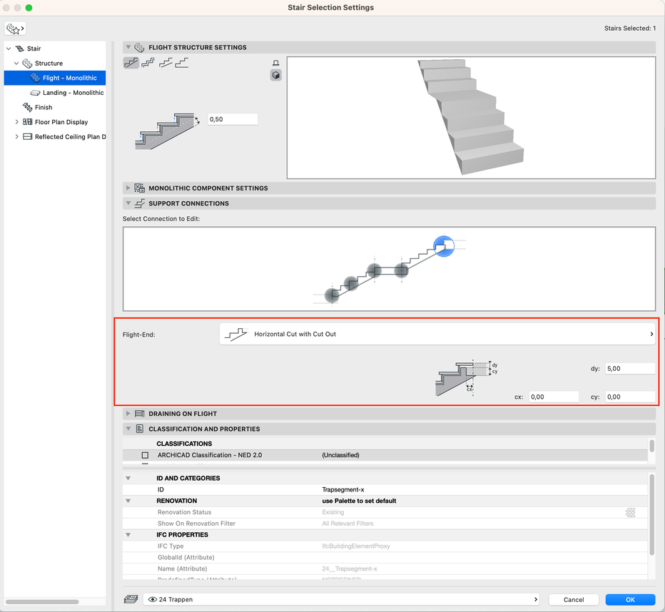

The stairs cut off at the top, how do I fix this?

I don't have Archicad running at the moment so I can't show you.
But in the stair structure settings you should see a section for 'connections'.
Check to see what is set for the flight top connection.
There is probably an offset from the top tread down to what you see in your image.
That is so the slab of the landing forms the top tread.
Just move your stair back so the front top riser is at the front of the landing.
If you set the top offset to zero (which you can) you will have a joining line between the stair and the landing.
