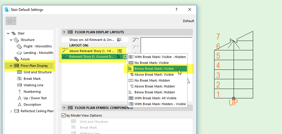

Is there a way to make the stair outline not show on the hidden portion?
For example, I've tried the above Stair Settings to hide the stairs above the Break Mark on the Main Level. The treads (goings?) are successfully hidden, as is the walking line and all other elements. But the outline of the stairs still shows where everything else is hidden...
I've tried changing "Floor Plan Display > Grid and Structure > Hidden Part > Grid Contour Line Type & Pen" settings to no avail.

Try the 'Floor Plan Display'.
There you can set how the stair is shown on each storey.
