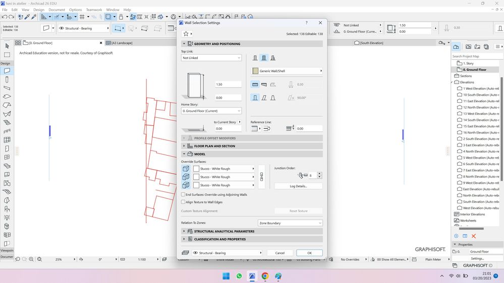

Hello,

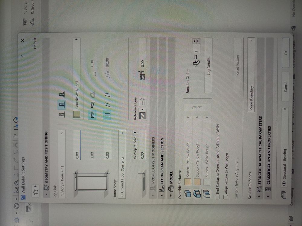

When I draw the ground floor and then I draw the first story, there is a space between them. space I think it is about a 1story height. What should I do?
Below are the photos with the 3d model, the ground floor settings and the first story settings.
Thank you!

Your top of walls are not linked to the next story and likely shorter than the story height. If you link them and set their distance to the next story to zero. The walls should fill the gap.

As @4hotshoes told you to set the top link to the story above and you did successfully, so now you should adjust your story height to be 1.50 m by pressing Ctrl +7 or right click on any story name in the Navigator & Select story settings then do it.

I tried to do as you said, but it does not work. Moreover, I am working at scale 1:200 and my height story should be 1.50, but I can not change the height.
