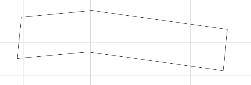

I'm looking at creating some stairs that looks similar to the line drawing below. I see that there some similar stairs in the library, but when I try to alter the angle for example, it comes up with errors which means that I can't design the stair required...
How can I create a stair to fit the required shape below ? Is there a tool that allows me to ' bend ' the stair in plan

You can have some options to do it
1: Very manual: build your own stair with separate SLABS
2: In the STAIR > CREATE STAIR, you can create your own stair from "POLYLINES" or something like that
3: Try out STAIR MAKER from CadImage
OR maybe you'll find something suit you ????
Cheers
vistasp
Mentor
In AC, press F1 and go to:
Virtual Building > Custom Stairs with StairMaker > Custom Stair Based on Manually Drawn Elements
It's not perfect, but it should do what you want.
