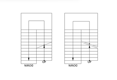

Hi everybody. I had a trouble with the Stair Tool's Break Mark. I have two stairs on one floor plan and the orientations of the break marks are different:
They're not mirrored or copied. The only difference between those two is only the width. One has the width of 1400mm while the other is 1500mm. I need the break marks to have one and the same orientation.

Tazo:
Under Stair Settings > Floor Plan Display > Break Mark > Break Mark Distance and Angle > Angle to Horizontal: try a negative value.
