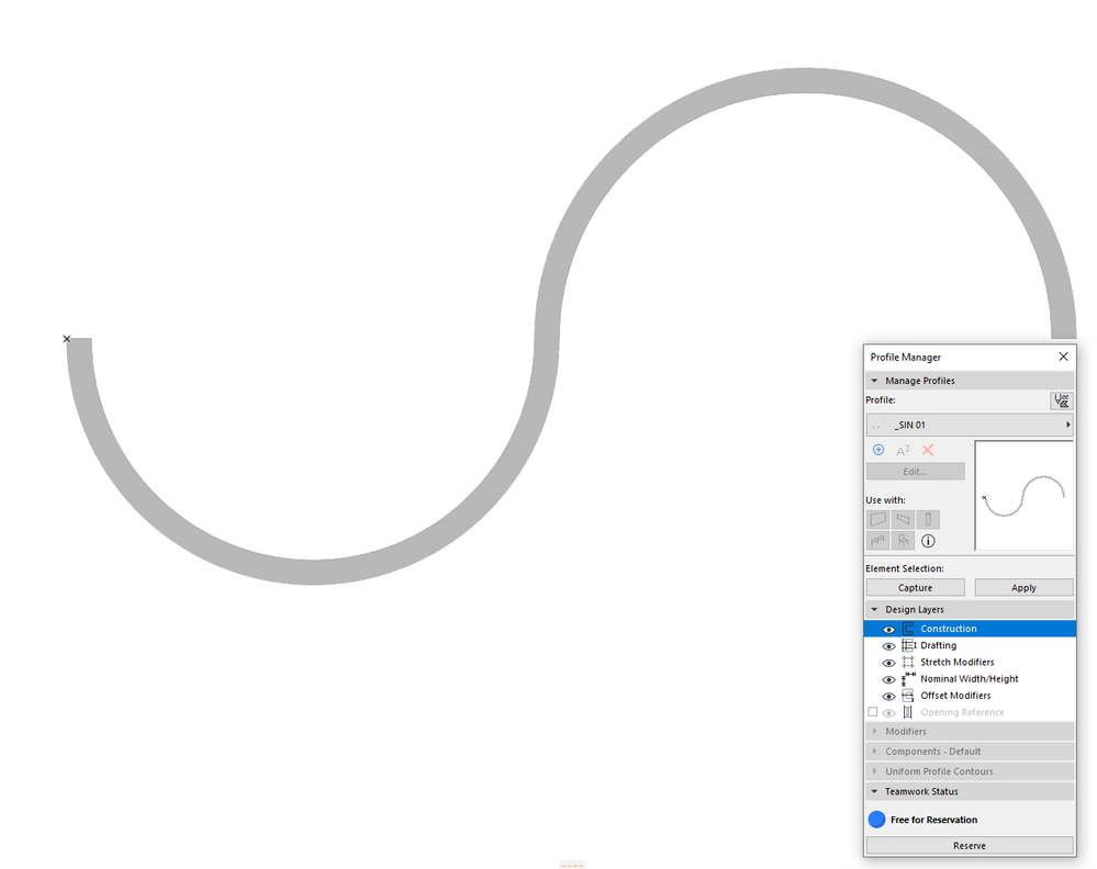

An updated version that works with complex profiles.
I can't remember if the other version I posted did that or not.
I may have tweaked something else as well (I am always tinkering).
The original one did. With joints? Hm...
Actually I think it did.
In this latest version I adjusted the positioning of the profile and allowed for it to be flipped front to back or side to side, to save creating new profiles.
Also allowed you to use different profile types (object, beam, column, rail and wall) just in case you have a profile already set up but was not saved allowing it to be used with objects.

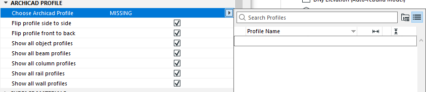

I have trouble using the object, the profiles won't show up. The steps I did:
1. Load the accessories library (I also had the Fassaden Extras for the original German object)

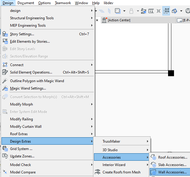

2. Select a wall in 3D then use the Wall Accessories feature
3. Select the .gsm from your comment and try to use a custom profile:
It should have it displayed, as it is available for all types:
Any ideas? Thanks!

That is strange.
It works in every version up to 26 (it was written in version 22).
But not in 27 or 28.
I haven't really been using those versions so never noticed.
I thought it might be to do with profiles having folders, but 26 has the folders as well and it works there.
For me it still uses the default profile the object is set to, even though it can't see it in the list of profiles.
But unless you have a complex profile with an attribute of 400, you will see nothing.
I will have to investigate a bit on this one.
That's a long standing bug GS never cared to fix.
In the "All Parameters" view GDL can not "see" any profiles anymore, BUT it still works when using a custom UI – that's why most people never ran into this issue, since in all OOTB objects with profile access the UI is always scripted.
Probably a "good enough" in GS' books, so this will surely line up in the hall of bugfame for the decades to come.
