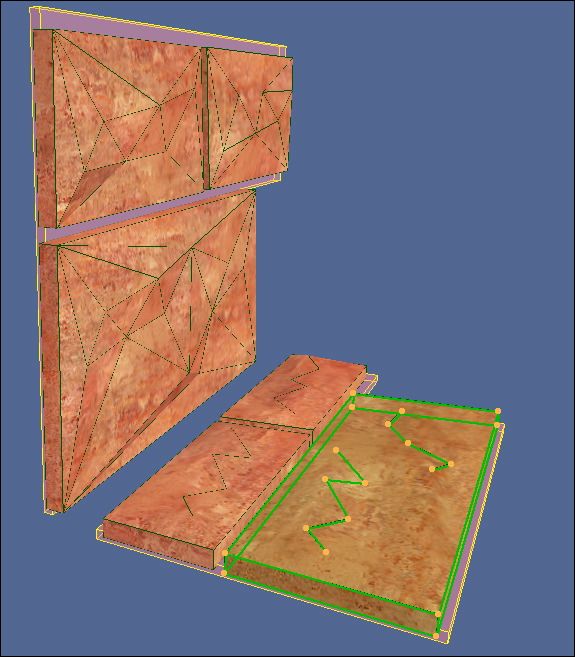

Dwight
you would need to model it.
This is not so hard.
What's rough stone?
Boulders, flat stacks, what?
I assume irregular rectangles.
Working in plan view as an elevation [ie; laid down], you'd build a matrix of irregular rectangle meshes with undulating surfaces. Do an infill with mortar and bob is your uncle.
The panel is "stood up" by making it a library obejct from a 3D view from wherever you think the top of it should be. This will make it into a panel applied to wall faces.
You might like to emulate a StoneCAD image to make your stone match their stone.... for a good texturemap overlay.

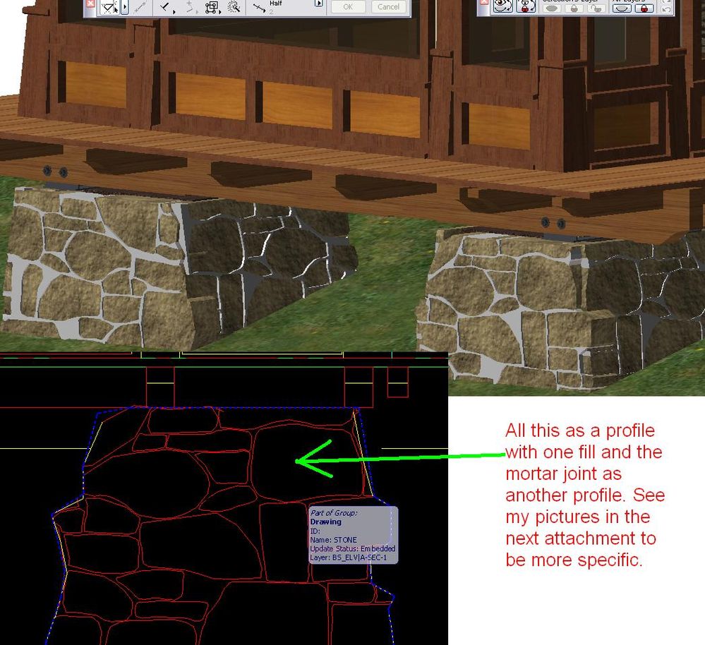

Srinivas
I am not sure, how much help this could be, but here is how I model the attached stone wall image.
I made 2 profiles, one with the entire stone and the other with the mortar finish and them place them on to the model, this i did for one of our client who is about to print their 3d model from my file.
I will attach remaining pics in the next posts.

Here is the Stone Profile
www.bimvizstudio.com
ArchiCAD Service
ArchiCAD since v9 to latest
Mac, Windows 11
Srinivas
Here is the Cement Mortar Profile, I generally give this slightly more thickness than the stone profile.
