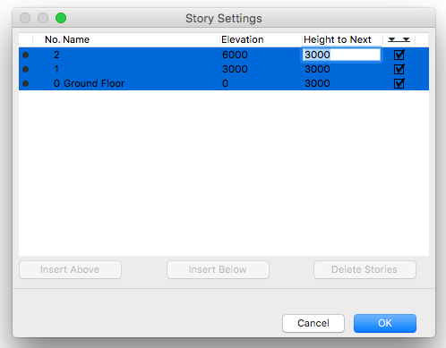

In AC20, you can also multi-select Stories and edit all Height to Next in one go.
