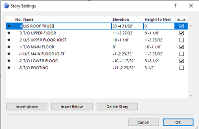

We use this technique for typical wood framed single family residential projects and it works great. Some elements need to be modeled on the U/S of floor joist story and set to show on one story above and below, but for the most part it's really straightforward. If our floor joist depth changes, it's really easy to update.
The issue Barry mentions about the break lines for stairs or railings is not a problem for us. I've never been happy with the 2D graphical output of the stair/railing tools and find it easier/quicker to draw them in 2D for plan views but model them in 3D on a layer that's hidden in plan view.
AC27 USA - build 6000 - HP ZBook 15 G6 - Intel(R) Core(TM) i7-9850H CPU @ 2.60GHz, 16GB RAM - Windows 10 Pro

It's one of the primary reasons. For split levels, we use reference stories, often for a dropped foyer or a bonus room over the front attached garage. I think you can only set two of them under project preferences.
Stories aren't just for floors, ceilings, or roofs... they can represent anything you might want to model. I used to use stories for different options - I created extra stories below the footings, turned them off in section view and modeled options there, however this is no longer needed with the design options feature in AC27.
