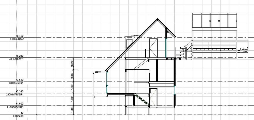

I have a complicated split level house which I am trying to model. It has lots of staggered half levels which need to be identified and labelled in cross sections. Unfortunately, every time a level is labelled in the Story Settings' tool, it also creates a story which splits the elevations and creates a level on which elevations, walls, and objects are created. It makes creating my model a nightmare.
Wouldn't it be useful if Archicad could distinguish between levels used for documentation and levels used to create models? In my case, I could then choose to only use main levels in the Story Settings to simplify modelling, and also create floor level labels that include the intermediate levels. Better still, AC could compromise its rigid approach to creating walls from story to story and allow walls to extend over multiple stories and half-stories, and display correctly on plans.
Perhaps the 'All relevant stories' option could be extended to do what it pretends to do. I still don't know what 'all relevant stories' means.

Take a look at the floorplan cutplane settings for your saved views. You can specify the range of the projection there.
For documentation on layouts, you might want to stitch together 2 views to create a floorplan.
This is how I've fixed this in the past.
All relevant stories means all stories where the floorplan cut plane range includes the element.

I do the 'patching' on the layout.
As a 'rule' I would make extra stories for splits that are sufficiently high up to merit marking out the lower bits as open space (no floor) and stitch together two saved views with different floor cutplane for the smaller steps in level.

I have no experience with Revit, however, unless you need the stories for some BIM reason (classifying elements as to belonging to a certain story ID), it is easy enough to draft up a 2D line in the section to act as the story level and to just disable the story markers and use the dimension tool to annotate the elevation/section height dimensions.
It is not easy, however, to go back on your story settings. So make sure you have a backup file, before deleting stories, as this will also remove all elements linked to those stories.
All that said, with floorplan cutplane settings, you can achieve a lot. You can customise per view how far up or down things should be projected and there is ussually an option to 'override', by settings elements to 'home story only', however that will probably not work for most walls and such that will span multiple split levels.

As for the layout, you are basically placing the two instances of the floor plan as drawing on the layout, cutting away / offsetting the bits you don't want to show and thus ending up with one stitched together plan.
Once your layout and views are setup, you are pretty much done for the rest of the project in terms of output.
