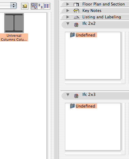

Right. I was wrong, at least as comes to objects using "Beam" option. (Not Beam object.) In one of only 20 or so obscure dialogs, with incomprehensible and well-hidden options, you can indeed emulate the behaviour of a Beam. Visually.
IFC is still "Undefined" and does not seem to be able to be "defined".
In the MAD Finnish parlance, a steel beam is internally classified as a "spatial accessory". ("AR 133 Tilavaruste"). Fancy that. Useless & pointless.
Other than for doing useful work or getting help from users, ArchiCAD seems to be most impressive...
(OK. I'll go and buy a yellow robe.)
This is confusing.
In the "Tree View" of the IFC-menu, the said objects appear to be correctly classified. In the "Edit Object" -dialog's IFC-section they are "Undefined".
I guess have to assume that they are OK in export! The (perceived?) main problem has therefore been solved.

Petri wrote:
... if I only knew how to apply an arbitrary IF-class.
GDL objects already belong to an IF class based on their subtype. if i'm reading the manual correctly, they are automatically assigned that class on export . . ?
b e n _ f r o s t
__archiben
and a quick check of a universal column subtype reveals it to be in the Model Element>Building Element>Column subtype . . . just like a the 'real' column tool columns . . .
b e n _ f r o s t
__archiben
make a quick steel/column object model and export as IFC to check once and for all . . . ? there are several free IFC 'viewer' applications . . .
i think it's a case of IFC being integrated at such a low level that it just works. you're over-complicating the process by going to look for it! and jumping up and down abusing the power users trying help isn't the best way of solving the problem either, eh?! 😉
although - it would be nice if the IF class of an objects subtype was revealed in the object's tool dialogue IFC pane . . .
hope it works out . . .
I surely would if I only could. The demo mode does not allow exporting.
Anyway, while in 99% of cases, the "built-in" IFC-assignments are fine, there still should be a mechanism for arbitrary classification. A beam used as a raked column, a wall used as a beam or a balustrade and so on.
Mind you, this is very easy in VectorWorks... (No, I don't want to discuss the matter here. Suffice to say, I obviously again have to decide between (a) a very high level of flexibility and then make do without some important features and (b) a very high level of functionality, with little, if any, flexibility.)
No, but neither is it the best way to entice members to the Cult to tell a prospective new devotee that the Scriptures say "in our church you don't do what you need to do, only what you are told to do". Even if you call yourself a Guru. (Usually people who call themselves gurus are anything but.)
Yes. One wonders what's it for... You don't see the IF class of some objects, you can't change it for any. What's the point, what's the b*dy point, as Basil Fawlty would once again say.
