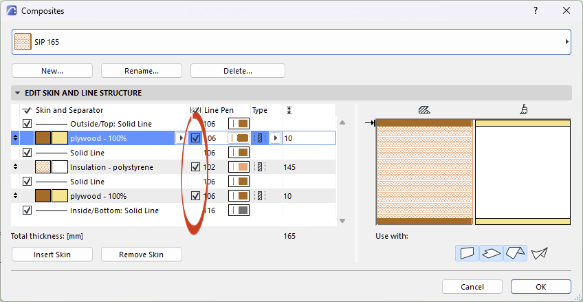

The position of the column is affecting how the wall trims.
This is just a guess without testing, but check your wall composite settings to see if the end lines are turned on.
This image is from 25, but 29 should be similar.
