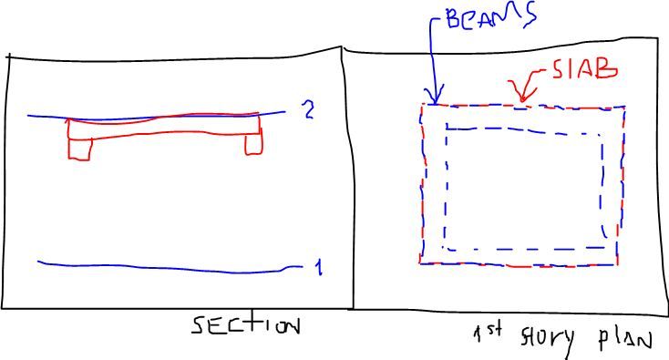

ok.. i want to draw a 2nd story slab and the beams that support it.. however.. both are projected on the 1st story with "hidden line" and they are superspositioned and instead of having a projected slab.. i have a continious line..
how do i make them match so i can see both projected lines..

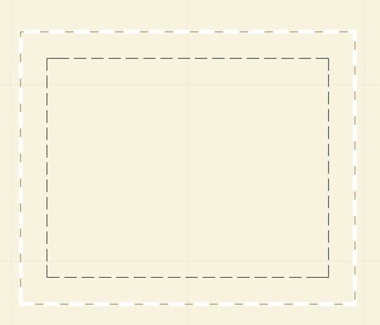

Do you mean that both the Slab is shown with hidden line and the Beam is also shown with hidden line, but around the outer edges these two hidden lines have their segments and gaps overlapping so it looks like a continuous line?
If the the problem is as Laszlo describes, one workaround could be to draw a 2d dashed line around the outer edge of the slab, using a thick white pen, and use draw order to ensure it displays at the front. This will mask the lines behind making them appear dashed, regardless of whether they actually are.
Not really in the spirit of BIM, but hope it helps!
jaja yes thats exactly what i ment.. but i was kind of looking for a BIM solution.. i thought maybe the software had an option to match these overlapping hidden lines.. that would be very useful

Another option would be to hide the layer of the floor slab and show only the 'beam'.
This would negate the two overlapping dashed lines.

The problem is coming from the fatc that for both dashed lines (slab and beam) have a different origins. The slab side and the beam side start from opposite sides. You could invert the direction of each beam individually, getting this way the same origin and correctly overlapping dashed lines,
Any way Erika's solution is the most BIM

i just found out that if i split the beam.. i can manually move it or mirror it so the dashed lines would match the slab's
