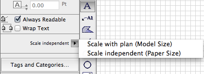

You have 2 choices with text in the settings - 'scale with plan' or 'scale independent'.
Scale with plan the text will stay the same size in relation to your plan so in effect it will get bigger or smaller as the scale of the plan changes.
Double the scale and the text will print twice as big - not always desirable especially if you want to keep the text a certain size when printing.
Scale independent means that the text will stay the same printable size regardless of the scale - i.e will always print as 2mm high.
The plan will get bigger or smaller but the text will stay the same size.
this means it looks like you text is changing size and/or position - it isn't - your plan is.
This method can work if you carefully place you text anchor point at the position where you want to thext to remain fixed.
i.e wall on the left with text to the right - anchor pont would be the left hand side of the text so as the scale changes the distance from the wall will remain the same scaled distance.
Wall on the right and text on the left you would anchor the ext on the right side of the text block.
The same applies for top and bottom.
Basically the anchor point of the text will remain in the same position relative to your plan so it will appear to still be readable.

These two radio buttons of the Text Settings Dialog in my ArchiCAD 17 are called "Model Size" and "Paper Size".
I probably wasn't looking at 17 at the time.
