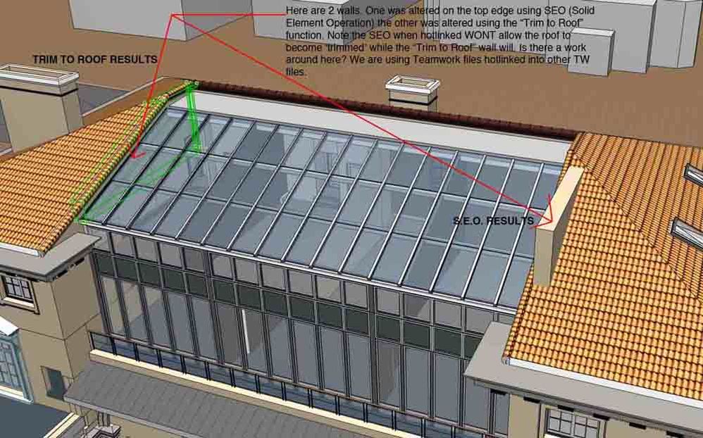

see attached.
it's explanatory.

For those who need a "written" explanation.
one wall (wall on left) was trimmed to roof.
wall on right was trimmed using a SEO operation.
Wall on left comes thru TW file and hotlink file fine.
Wall on right protrudes thru roof (even though there was an SEO operation performed).
Files are TeamWork files.
Files are Hotlinked (TW Hotlinked) one into the other one.
Please advise.

I'm sure this has been discussed before. Inter-story SEOs do not work with HLMs. You must use Trim to Roof.
