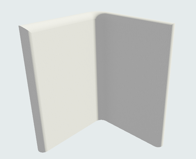

Hello everyone, I'm trying to fillet a straight wall with a tilted wall, from outside, and the filleting is not following the straight wall from its side. (see image below)
I saw a previous post about this subject and the solution was to solve the corner with morph and convert also the rest of the walls to have a unite result in the floor plan. Is there any other way? I'm sceptical about the morphs since it's not so easy to make any changes coming in later construction phases and moreover how the structure composites will be depicted with morphs?

You can use Column & Beam to achieve this result.
Edit: sorry i think i misunderstood your question but i guess you can't have this fillet between a srtaight wall and a tilted one, thx.

The only option I would try is using a Shell for the "fillet" because you will have different radii at the top and bottom of the inclined wall.
