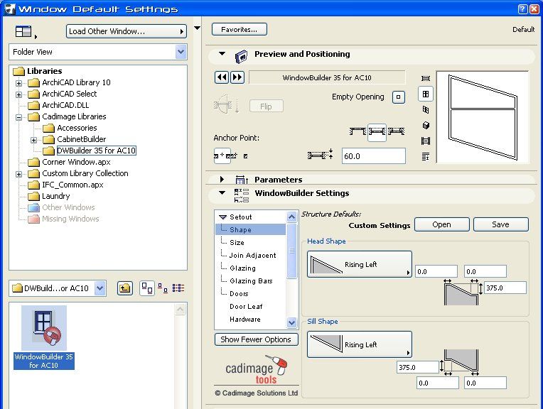

Now I see exactly what Jennifer is after, I don't think DWB can do this. If it was just a matter of splaying head or sill of the window that would be no problem. Jambs don't seem to have an option for sloping.
Attached shows an elevation in the preview window, head and sill sloping.
