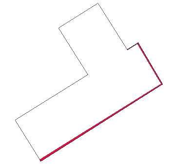

I want to have one material around the little wall end. Because of ID and 2D appearance I don't want to add a small wall. I tried the wall end tool but I couldn't find a way to make a simple wall end that is perpendicular to the wall reference side.

I am not sure of your requirements but you can make the width of the side material of a Cased End any lenght and width you want the small wall to be.
It will show up as a small wall perpendicular to your wall reference line.
