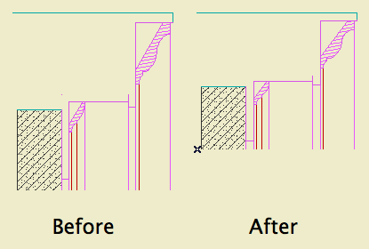

With the detail tool and a well-developed model, trim details (e.g.) can be developed pretty quickly. The oddball is anything sloped, since there's no way to cut a non-plumb section. You need to take extra steps to correct the distortion arising from cutting through sloped elements. A conventional resize won't work, because you can't restrict it to one axis.
The trick is to create a patch and adjust its vertical dimension.

Either way, you're squeezing the patch so the vertical dimensions of the elements are right again. Horizontal is unchanged.
