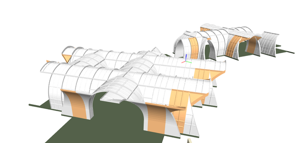

Hi all,
I have come to this forum based on the project we received which contains Non-Load Bearing Element as shown below:
The element (Domes in White Colour) Material for our analysis is Fibre Reinforced Polymer.
This model was received as IFC produced out of Archicad.
Issues Encountered:
  1. Based on Research and Query, we understand these Domes were modeled as a Non-Load bearing Curtain Wall. Which has now Translated into IfcBuildingElementProxy in the IFC file.
  2. When tried to import into Structural Analysis Software, it does not recognise as IFC Plate which is the general Norm for BIM Seamless integration. Hence, its not visible or recognisable in any Structural Analysis Software.
Question:
How can we (without breaking our head) transform this element into an Structurally Analysable Element and integrate into our software (which could be STAAD.Pro / SAP2000) ?
If some one could explain a tested and proven Work Flow.
Any Help is appreciated.

the easiest way is to ask the architects to re-publish the IFC file with these elements set to the correct Structural Function. i don't think you're able to change anything in the IFC model at your end (I could be totally wrong).
to avoid errors such as these, in the future, tell them to "use Graphic Overrides to visually indicate which elements of the building are Loadbearing VS non-Loadbearing". we do that a lot & it's sickeningly quick & easy to spot which elements are loadbearing/non-loadbearing/undefined.
