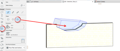

I really need to make these kind of walls (see the picture) where in elevation looks like a trapez. I tried to make a slab with that shape in floor plan but I do not know how to flip it vertically.

Use a regular wall and add a custom shape opening to create the slope.
Or you could use something like a morph, but it won't be considered a wall, so no doors or windows.

In addition to Barry's suggestions, you can use a Roof to SEO (Solid Element Operation) the Wall, then hide the Roof's layer.

Hello! I tried but I think I did something wrong because it doesn"t work.

The opening can be any shape you want.
Just place it and adjust the shape.
