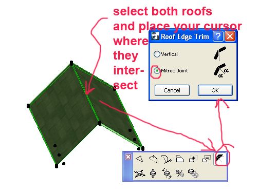

Erika Epstein
select the two roofs and place your cursor where they intersect.
select the right-most pet palette button . this gives you the ROOF EDGE TRIM box. Here choose the Mitered radio button.

Fran_ois Chatelain
Hi Erika,
why would you choose mitered in that particular example;-)

Erika Epstein
François,
I'm in the habit of just picking mitered although in the example shown I would get the same result had I chosen vertical.

Karl Ottenstein
Hi Erika!
Just when I thought there was nothing I hadn't seen before ... you present a strange new dialog!
I've always used ctrl-click (cmd-click) to cause roof edges to automatically meet and trim - or used the pet palette on a single roof element to get the roof edge angle customization dialog.
But, I never knew you could select two roofs and mercedes-down on their 'joint' to get this joint customization dialog. I just searched, and cannot find this dialog in the online help or the PDF Reference Guide.
Using this method doesn't work for me in a small test example in AC 12. I joined a 30 degree roof to a 45 degree one and viewed in section to verify the linework I was seeing in 3D. The 'vertical' joint works, but when I select 'mitered', the angle of only one of the two selected roofs is adjusted - the other is still vertical. I would expect miter to bisect the angle between the two roofs. You can see in the attached screenshot how the roof plane on the right is using the edge angle for 'miter' - but the left roof plane did not get re-adjusted.
I would have to manually use the edge angle palette on the first, read the angle, do the math, and then select the edge of the other roof for the complementary angle.
Did 'miter' work in earlier versions of AC with dissimilar sloped roofs? Wonder if this is a bug or user error on my part.
Thanks for showing me something new, even if the implementation might be buggy! 😉
