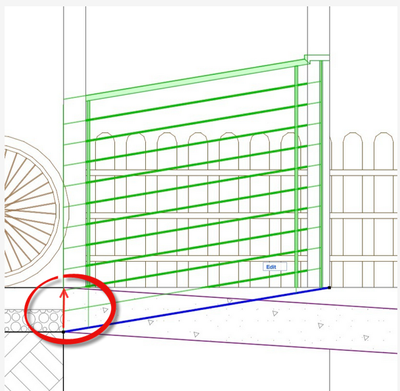

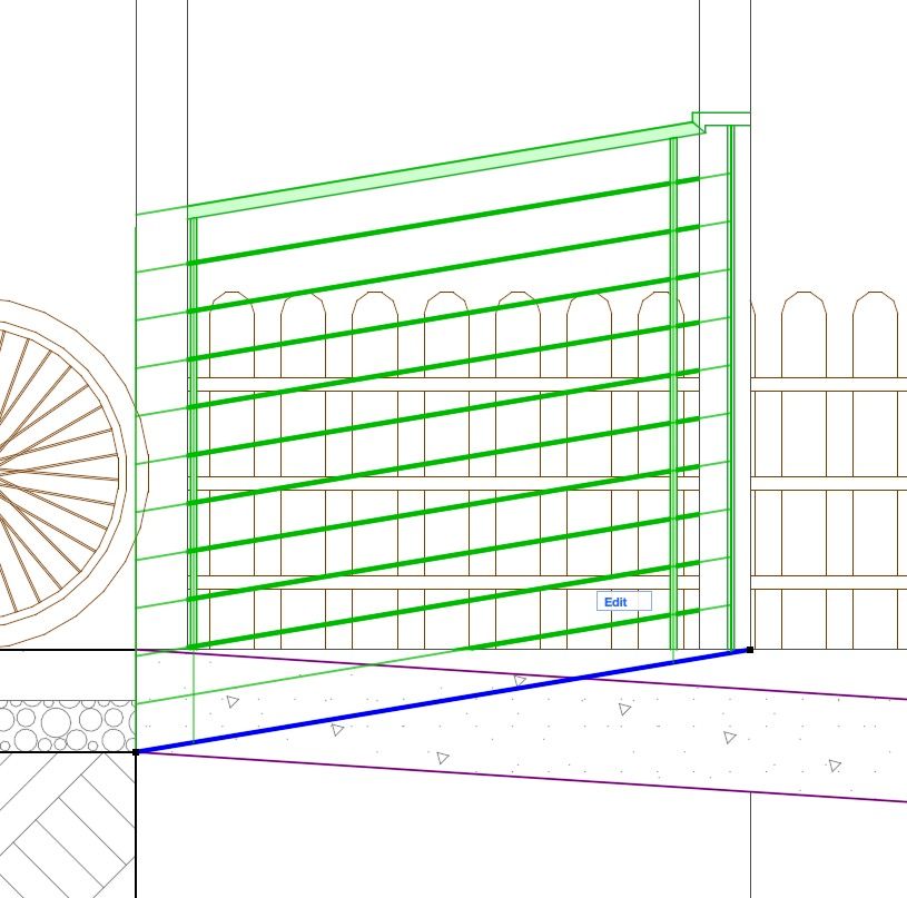

I'm trying to make horizontal railings for a deck however they keep making themselves sloped at the ends. I can't seem to find the setting to get the railings to not do that. Can someone suggest a solution? I'm new to Archicad but so far the good has outweighed the annoying things about Archicad. Thanks.
Screen Shot 2022-02-25 at 9.38.49 PM.jpgScreen Shot 2022-02-25 at 9.39.18 PM.jpg

You can do this in your elavation view or in your 3D view along the Z-axis.

The railing will follow the blue reference kine.
On end is at the top of the slab and the other end as at the bottom.
You should be able to select the node at the end of the line and drag it up.

Thank you Dontknow and Barry. I was able to find the move node tool in the pet pallet and make the adjustment in the elevation view. Thank you.
