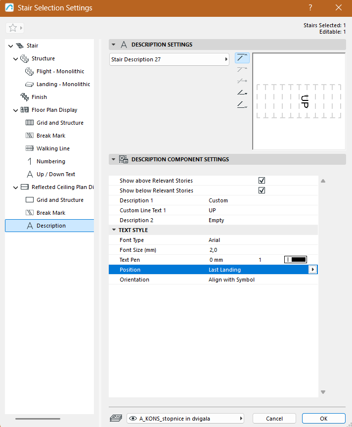

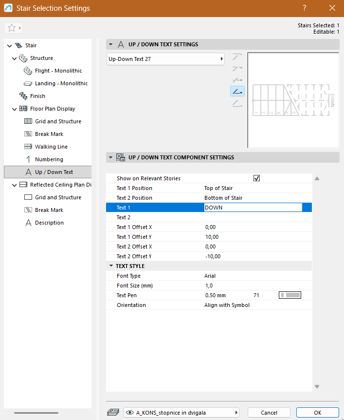

Hi
I am not sure if I am understanding this correctly, but this is what I would do;
Stairs are based on home story, not the linked one, so I think that (linked story) is irrelevant.
On "floor plan display" I would simply erase the "up" text (or the "down", which one you want)
As for "reflected ceiling plan display" I would check the description and use custom line text, then change its position and orientation.
I had some problem with the stairs so that last thing didn't work for me. Maybe there are some overrides or maybe I'm doing something wrong.
Hopefully, this helps you.
