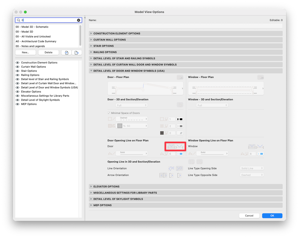

what setting is it that sets to door swings to a straight line and changes it back to an arc?
2026-07-24 10:23 PM - last edited on 2026-07-25 02:48 AM by Barry Kelly
If you are using the Global library, it should appear under the Model View Options under:
'DETAIL LEVEL OF DOOR AND WINDOW SYMBOLS > Door Opening Line on Floor Plan'
