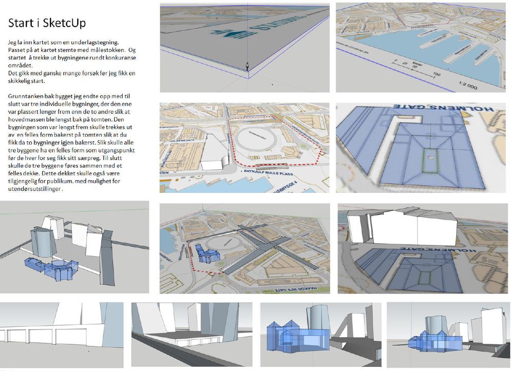

SketchUp and ArchiCAD work well together when forming an urban landscape. A former BIM student of mine, Torgeir Rønsen (from the Firm BIM Concept http://www.bimconcept.no/), made this City Plan when making a model of the Vestbanen Project of Statsbygg in Oslo, Norway.

Ingolf
...and the attachment follows... (sorry for the Norwegian text)
