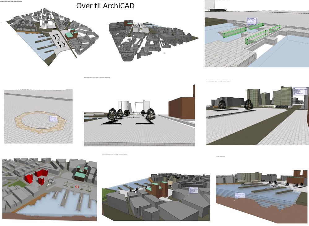

SketchUp and ArchiCAD work well together when forming an urban landscape. A former BIM student of mine, Torgeir Rønsen (from the Firm BIM Concept http://www.bimconcept.no/), made this City Plan when making a model of the Vestbanen Project of Statsbygg in Oslo, Norway.
Ingolf Sundfør, Bricklayer, Author of several Real Life Problem Solving Books for Archicaddicts in Norway.

...and the attachment follows... (sorry for the Norwegian text)

ArchiCAD has detailed and powerfull possibilities to model an urban landscape even further. This plan was concieved in a single week... (From Torgeir Rønsen, http://www.bimconcept.no/)

WOW !
