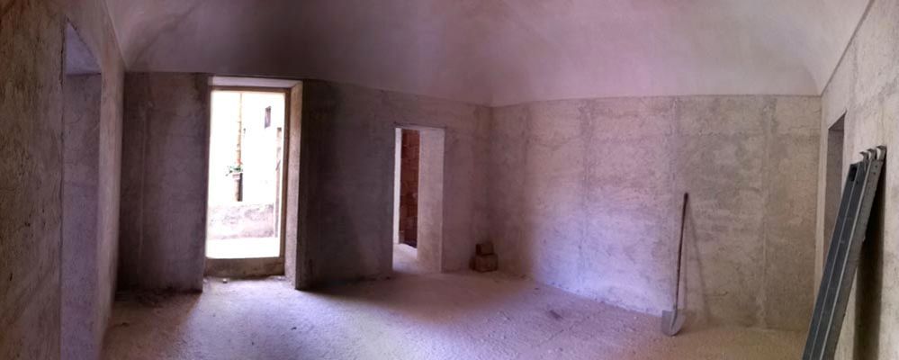

I am trying to model a ceiling similar to the one pictured below. Basically trying to achieve a vaulted ceiling where the lines in the corners fade away as they emanate from the corner. Does anyone have any thoughts? Maybe the shell tool? Although I haven't been able to make it cooperate. Thanks in advance!
-Chris

This actually worked really nicely. Since the rooms are not perfectly square, each side of the ceiling needed to be unique complex profile. The general shape of each profile was similar, only the distance to reach the center of the room changed. Sometimes the simplest solution is one that has been around in AC for a while! Duh! Thanks for everyone's input.
-c
