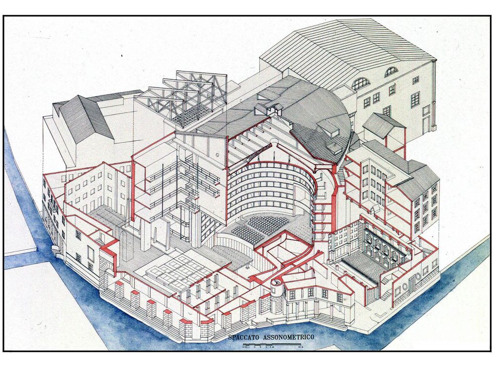

Hello everyone,
does anybody know how to make the type of section in the image below? I cant find out how to limit the 3d section plane: it just cuts the building all the eay to the end. I have been searching for a way to do this for quite a long time.
Thank you in advance!

If you are on ArchiCAD17 and higher: create a building material with 999 priority. Make one or several shapes with slab tool, morph tool, whatever works best using this building material. Put it on a layer that is hidden. It should intersect with most of your model, depending on layer intersection group.

It worked! Very ingenious manner to solve this problem. Thank you very much!
