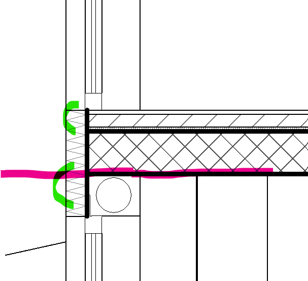

Visible thick wall cut line when i insert window or door.
I have a problem with a wall line in section. When i insert door or window thicker wall cut line (part of the composite wall) is visible. It happens above slab and also under the slab where sunshade is inserted. I drawn red line just to show where the lower floor wall ends and the upper one begins.

Hi @ThiagoMar,
Have you reviewed the pen assigned between layers in the composites?
Best,
Rubia Torres
