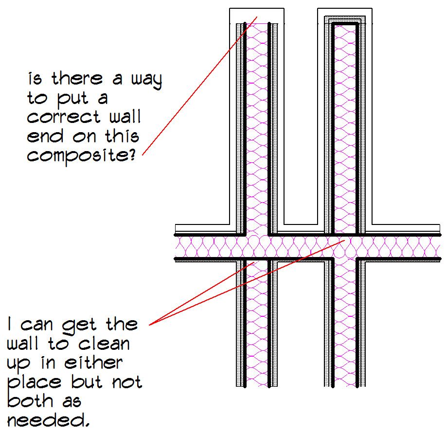

Any ideas how to clean this up and add a correct wall end for this composite?

Hi Steve,
Have you tried the Wall End tool? The 'Returned End' type should work for you, but you will need to tell it how many skins to turn.
It is also a little flakey if you have skins that don't have skin end lines.
Hope that helps.
Thanks. This is close enough for now.
Jere
If it's really critical, you could always just make a matching complex profiled column and place it at the end of the wall.

It's not critical, it's just too bad when the tool is almost able to do the job.
I will keep tweaking the wall to see if there is some end wall line or something that would make it perfect.
As I mentioned, the missing line is probably caused by the outer skin not having a skin end line assigned in the composite settings. It's easy to change to test if it works.
