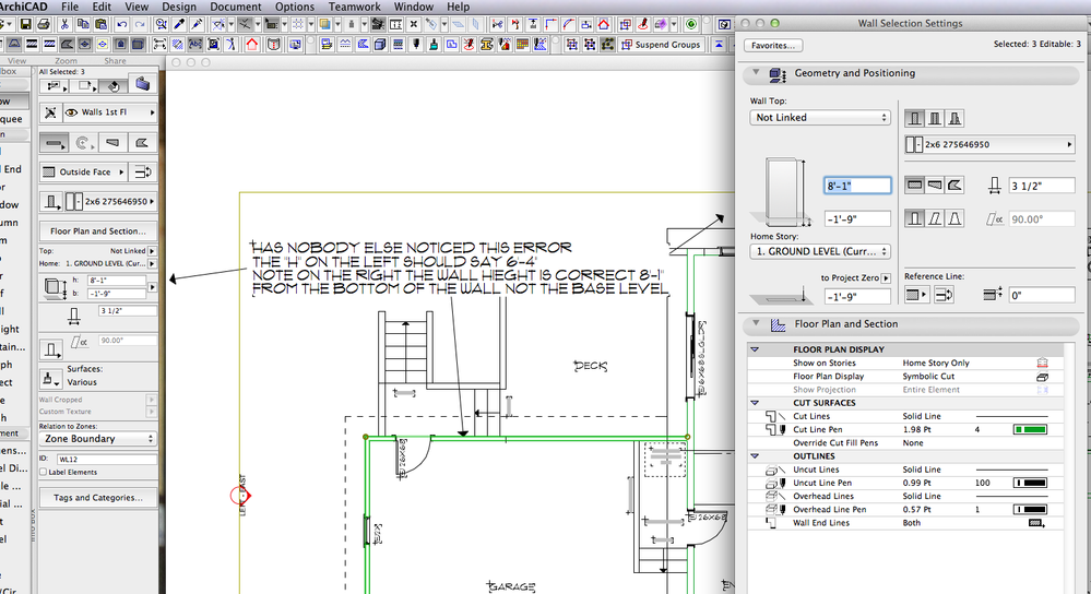

laszlonagy wrote:Thanks for the clarification.
Stuart, that option becomes enabled only when the Top of the Wall is linked to a Story.
With the "Not linked" option for the Wall top it is not available.
And Ron, yes, that little arrow gives you access to the various options.
In your case I think the "Current Story" option will provide you with the way it worked in AC16.
(Actually, in that case the H: text - which is for Height - will turn back to T: - which is for Top)
