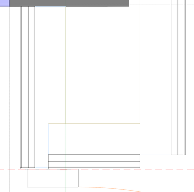

Wall Intersect
Sometimes intersecting walls together work, and sometimes it doesnt. Walls are the same height, same composite. Please help!
3 Replies 3
The walls need to touch before they will automatically intersect with each other.
If they don't touch you can manually extend them or use the intersect tool.
Lingwisyer
Guru
ctrl + i
Charlie64
I'd like to add that it's also important how they intersect. The reference blue lines need to intersect.
