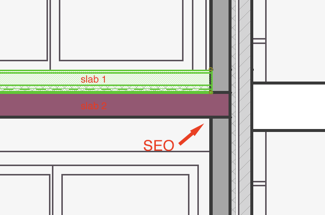

How can I make a Wall and a Slab intersect properly in section?
I made a compposite wall and a composite slab with the same priorities and fills and I have "Enable Skin Priorities" switched on.
In the section window they intersect proprly only when the Slab touches the Wall. When the Slab touches the inner Composite's line they do not intersect at all!

AFAIK it's still not possible to have composite floors intersect properly in ArchiCAD.

Here is an article related to the topic found on Archicadwiki:
http://www.archicadwiki.com/TechNotes/Wall-Slab_Intersections

You could also place the beam within the wall - as it really would be a beam, not necessarily a part of the slab. With the same cut fills, it would clear up?

Thank you for your suggestions! It is sad I already know them but don't like them! SEO is fine, but its more work! Beam is the right solution but it takes even mote time to model and I usually don't have a lot of time!
Here is a typical building detail I model (and draw!) in 90% of my projects. It is reinforced concrete structure with slabs without beams and brick walls with outside thermal insulation. All suggestions are welcomed!
I am struggling with the same problem. We probably have many similar structures in Hungary and Bulgaria.
I usually model only the Slab structure in the inside of the building. Then I place the rest of the floor as 2D in the Sections where they are visible.
I also model the exterior floor structures (e.g. floor structure of a balcony) using a separate Slab. I could not come up with a better solution yet.
I totaly agree with Djordje. We are doing BIM or what?...
I only use this kind of detail in CD drawings...
In the concept phase I use a special template where I use generic composites for slabs, walls and roofs...
I also make the slab inside the building like Laszlonagy does, but without 2d patch in section.
So... When I need to detail the model I just detail the generic composites changing them with the attribute manager,
and then I place the beams with the thickness of the concrete slab.
For me it works like a charm.
Braza, you did not read my explanation! It is "reinforced concrete structure with slabs without beams". Perhaps there is another term for it in English but it is still the same - no visible beams, so no beams need to be drawn separately!
Laszlo, you mean that an (ex)Hungarian CAD company does not offer a way to model a typical building detail, used in Hungary?!
Perhaps, if you ask them in Hungarian they will hear you/us? 😉
I model the slab according to the outside boundary of the masonry, as shown on the plan snapshot, because this is the slab contour I send the Structural Engineer. On this slab I show all the holes for installations - electrical, water, sewage, etc., so it must be drawn correctly.
I do not use a separate slab for balconies when I have a structure without beams, because the slab and floor thickness are practically the same. I only model a separate slab when I have a structure with slabs and beams and the balcony slab is thinner than the floor slab.
