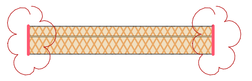

Similar issue, old thread.
I don't know how to change the wall end lines...!
In Wall Selection Settings > Wall End Lines, the line appears randomly as a thick red line.
  • My wall is a Profile Wall (not a Composite, where you can set the wall end line pen)
  • I would prefer to use the the Wall End Tool to wrap the skin, but Wall End Tool won't recognize a Profile wall, based on my experiments
  • So now I just want to change the red end-line pen to black
Any help please?
____________________________
Running AC25 on Mac OS 12.2.1
(Psst not a newbie, just lost my old user profile...)
When you select a fill in the profile editor, you can control the cut end line.
