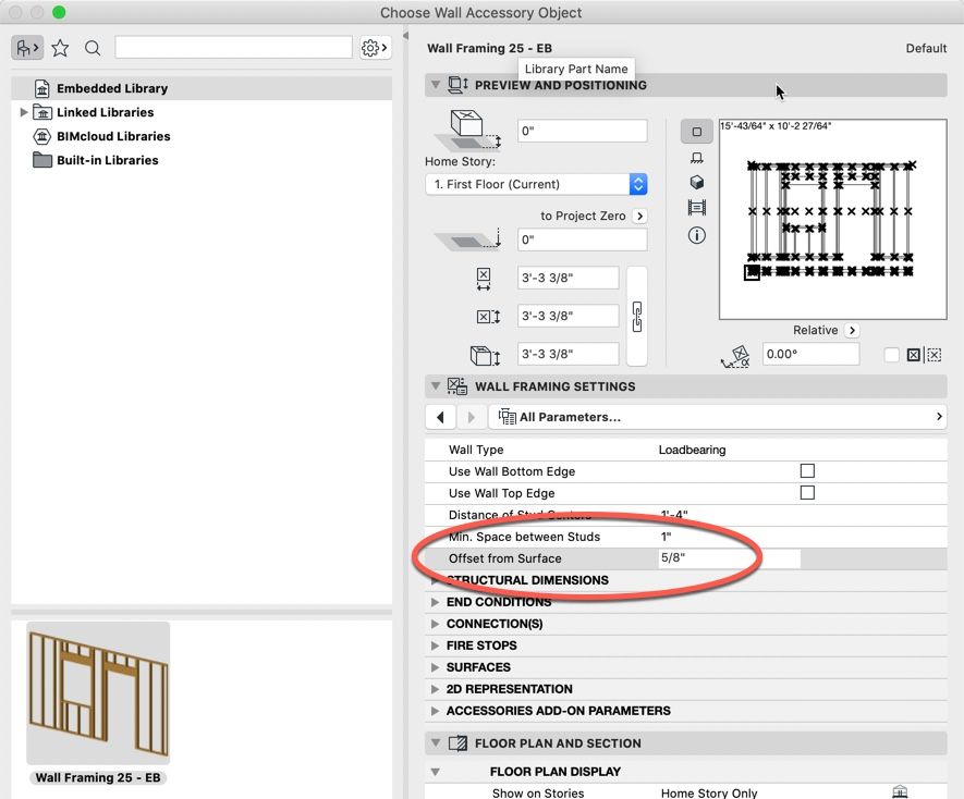

I was trying the wall framing accessory again today, but still can't figure out how to control the location in relation to the framing cavity; it always comes in offset. Am I missing some obvious control? Is there something special that one needs to do with the wall composite reference line?
I can drag the framing into position, but it resets out of the wall cavity whenever I modify a door or window (and it recalculates).
If anyone has some clues for this issue, I'd greatly appreciate your advice.

FYI - I opened up the Wall Framing 25 object and did some simple GDL editing to:
1. Add an Offset parameter
2. Edited the 2D script to use this surface_offset parameter (right near the top of the script):
add2 0,-stud_w/2 - surface_offset
3. Edited the 3D script to use this parameter (also near the top of the script):
if ac_refSide then
    addy stud_w/2 + surface_offset
else
    addy -stud_w/2 - surface_offset
endif
Now the wall framing sits nicely inside the wall cavity at the predefined offset (which should be set to equal the interior drywall thickness).
I found that when following the prompts to "click the side" for where to position the framing, that it worked best when clicking the interior of the building. This allowed the corner options to work properly when using the corner connection with two perpendicular framing pieces.

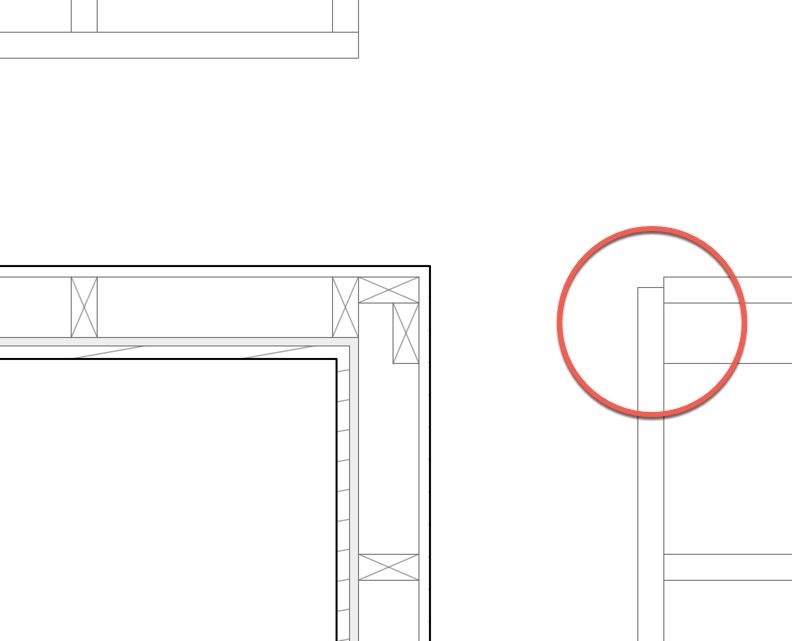

I did notice that the wall framing code had a small issue with the top and bottom plate for the inside corners, as evidenced in this screenshot - you'll see that the framing for the wall running horizontally ends properly, whereas the wall running up and down (onscreen) has a small offset for the bottom plate (it shows in the top plate as well):
This issue shows up in the original wall framing object; it was not introduced in my code modifications.
I won't be spending any more time on this coding effort myself; I'm sure that @SenecaDesignLLC  has done a much more thorough job on reworking this object. However it was interesting to see that such a simple change could actually resolve the main issue - fitting the framing into the wall cavity.

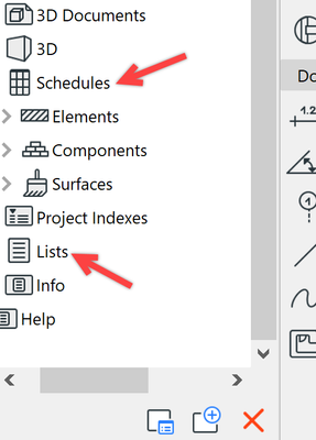

Maybe I am not understanding the difference between a schedule of lumber or a list of lumber?
Steve Jepson
A List in Archicad speak is not an Interactive Schedule.
I use both for a few things occasionally, but mostly just Interactive Schedules.
So I have my object set up for schedules then not lists.
Listing to me is any schedule that gives you a quantity.
I have never used lists in Archicad
