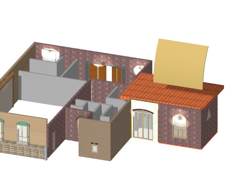

This curve WALL on the 2nd story keep bouncing off the slab when trying to mount it . Can anyone instruct me on what I am doing wrong ?

What do you mean by "Mounting a Wall"? What exactly are you trying to achieve?

Did I use the wrong terminology ? the image on the attach is self explanatory , l want to install the WALL on the surface slab , you can see it bouncing off.
You mean that you want the base (bottom) of the Wall to be at the same level vertically as the top surface of the Slab?
Try to place it by using the Gravity feature or the Surface Snap feature.
Or, if it is placed above it, just drag it vertically downward by its base to the top surface of the Slab.
It would be a good idea for you to put your ArchiCAD version an computer specs in your signature as some of these features (namely, Surface Snap) were introduced in later ArchiCAD versions.

i am using archicad version 18 you can show me how to put it as signature. That curve wall does nt work good either , i have to skipp it.
