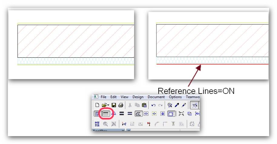

Maybe you activate "Reference Lines"?

I don't have that toolbar so and i can't find any reference line option in the view menu?
