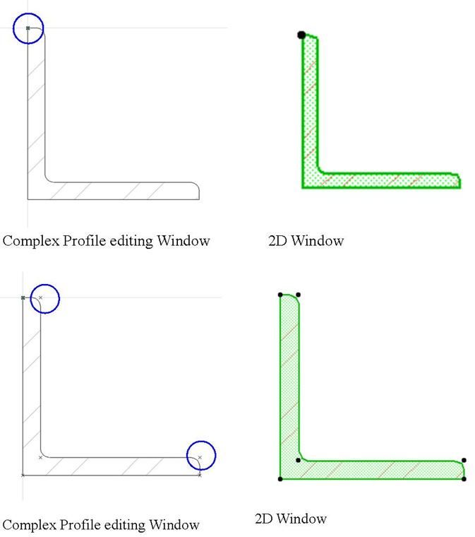

Regards to your third question...
I have found that when you place hotspots in the complex profile editing window and save your profile with those hotspots it also then creates more hotspots in your 2D window within ArchiCAD.
Maybe the picture shows it better...
hope it helps.

Cecilia, I can see from your example what the hot spots do. Archiben, you said the Core elements can be dimensioned to within the wall. That makes sense.
