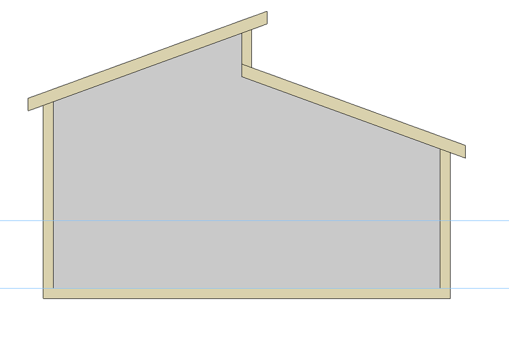

Barry wrote:Thanks for the info. I tried Junction Order in Wall Settings with no luck, but Intersection Priority In Building Materials did the trick. I would never have never have found it without your instruction. Thanks again.
Either use a building material in the roof that is stronger than the building material in the wall or do a Solid Element Operation instead of connect/trim to roof.
2018-06-22 02:47 AM
KrisM wrote:If the SEO worked on a morph it would have worked on a roof as well regardless of building material strength.
I had the same problem the other day. Tried all the suggestions but none worked. What did work was to convert the roofs to morphs and then use solid element operations.

Thanks for the help,
I had the same problem so I copied the material of the wall, made it a little bit stronger and used it for the roof. In 3D working great, but now in section I don't visualiza anymore the wall and the roof like the same material (ovviusly).
I can I solve that?
