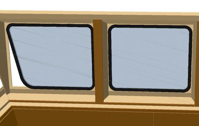

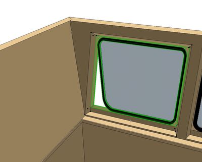

You cannot do this as the Leaf / Panel does not have any connection to the Wallhole, it is just a custom defined rectangular shape that is stretched to fit the opening. There is no easy way to achieve this as far as I know as the majority of macros used are based on a rectangular opening created by A & B.

To be more specific - I want to save it as a window leaf (panel), not the window itself. It's the other option possible in the 'save as..' dropdown menu.
Both of these were created as a custom window panel. The right one is ok, rounded corners are as they should so wallhole ID worked fine.
But the left one is still wrong - there is a hole in the left bottom corner. why?

ok...............now I understand the problem.
