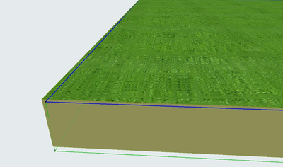

Hello there. Have you ever had this situation in ARCHICAD 25 or 26? When you go to 3D view, there's a very strange display. The surfaces are strange and also the ridges are weird looking:

Is your model very far away from the origin? That's the only time I've ever had the reference lines offset like that. If so, is it possible to move your entire model closer to the origin (0,0) in model space? Graphisoft generally recommends modeling as close to origin as possible, as it's a known issue that being very far away from it can cause glitches.

Wow, that was the case. thank you!
