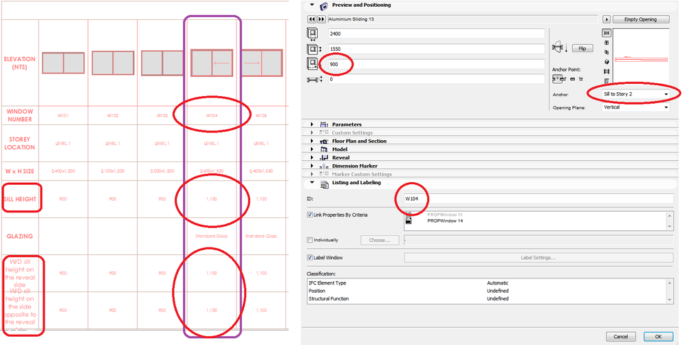

I'm doing up a Window Schedule & I'd like to put in the sill heights for each window. Most of the other windows are fine, but I've got upper level external windows whose walls go down 200mm below the Storey Level & the Scheduler calls up these external windows as having a 1100mm sill -- 200mm more because of the lowered wall, despite the fact that the window's Anchor Points are set to the Storey Level & NOT to the bottom of the wall. Heck, I've even called it up as having a 900mm sill in the Preview & Positioning part of the Window Settings.
I'd like to have these show the sill heights according to the proper Anchor Points (which in this case, are to the Storey Levels).

i found a fix to it. I brought in "W/D nominal sill height" under the Available Parameters of the Scheme Settings. & it shows the proper sill height relative to the Anchor Point settings (Sill to Wall Base or Sill to Storey Level etc.)
rather annoying that the dimension in the "Sill or Header Height" doesn't show properly in the Schedule.
