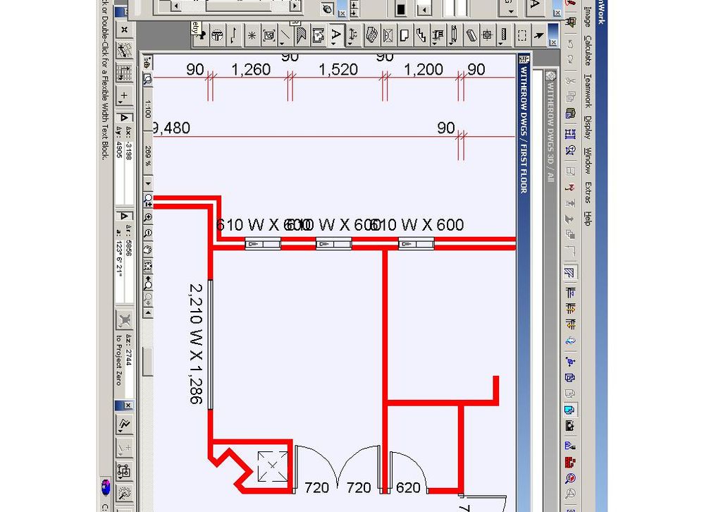

1. Please find attached windows with associated text. Is there a way for the text size to remain, keep associated with window, but move text to be read more clearly?
Play around with the window marker settings in the window settings dialog box

Thanks for the reply.
1. I'm using the "Basic Window-Door Marker" it seems I can only change the text height and unable to relocate the text, as required.

fuzzytnth3
You adjust the Marker position using the Dimension settings from within the Door or Window dialogue box. See attached screenshot

Hi Fuzzy
Thanks for your reply regarding the window text. That's exactly what I'm after, but......
I've attached a snap shot of the window/door settings, (ArchiCAD 8.1) I'm unable to gain access to "Custom Settings" and "Marker Custom Settings". Perhaps, you know of a way to access these?
I've also checked "Dimension Marker" but there are no settings to relocate text.

Erika Epstein
Lucia,
You might try the "Door Marker" and similar "Window Marker" options. These allow one to fully customize their appearance and access the settings you are after. I particularly like to check the "show editable hotspots" under "Marker Custom Settings". The editable hotspots allow you to move the different parts of the marker around while in the plan; y\ou can move elements independently of one another to accommodate the specific individual situations.

fuzzytnth3
In your screenshot the Dimension Marker tab looks like it will expand aren't the settings you are looking for in there?

Hi Erika
Thanks for your reply, I would love to use this option but the "Marker Custom Settings" is greyed out, so unable to gain access.

fuzzytnth3
I suspect what is wrong is that you don't have the ArchiCAD 81 library loaded and therefore the WD Marker object isn't available.
I found that the old ArchiCAD 7 marker doesn't work with ArchiCAD 8 so you have to have the ArchiCAD 81 library loaded
If you refer to the attached screenshot you will see that the Marker WD Marker is available in my pop-up list. If it isn't in yours then it is because that object isn't loaded in your libraries

fuzzytnth3
The Basic window marker doesn't give you access to modify the position of the text btw you definetely need to use the WD Marker
