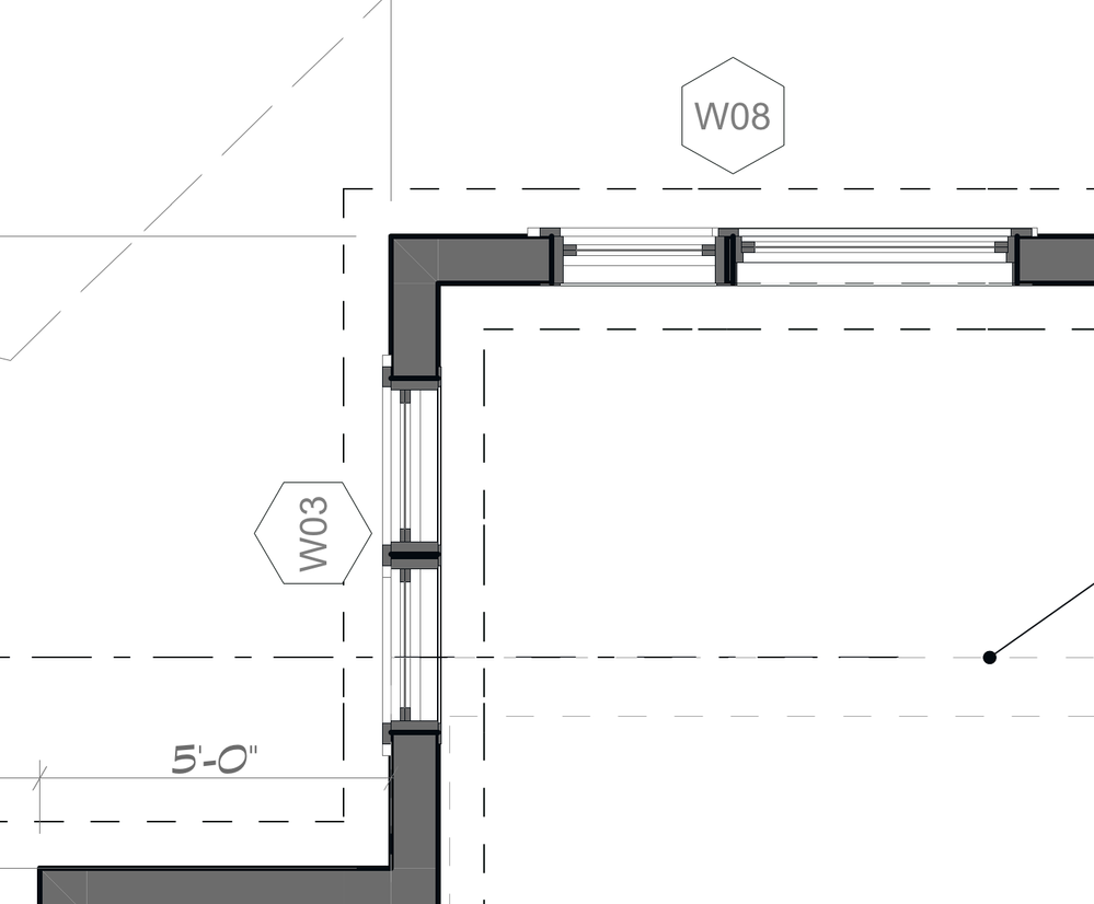

Below I have attached an image of a typical window + wall scenario.
What bugs me graphically is that the RO for the window has a dark cut line..it should not look this way.
Any thoughts on getting rid of that thick line behind the window frame?

You should try finding the Ganging settings for the Window.
For most Windows, in the Basic Settings Panel, there is a Fixtures and Fittings page and the Ganging checkboxes are found there.
For the two Windows, you should check Ganging for Left Side for one, and check Ganging for Right Side for the other.
See if that helps.
