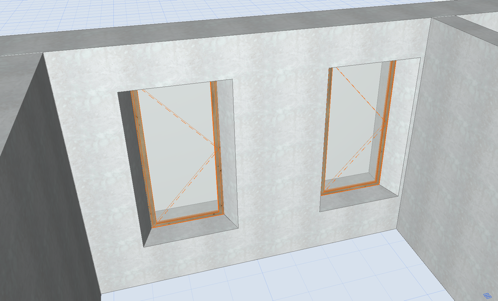

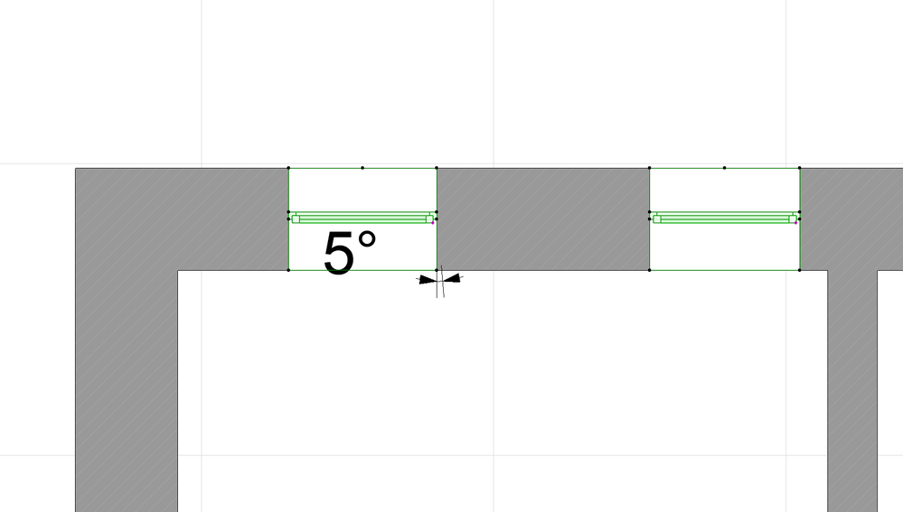

I'm having some issues with my floor plan not showing window reveals and was wondering if anyone knows why?
The window settings seem to be ok, the reveal even shows in 3D views. But in floor plans they're non existent?

Never mind... The window floor plan display setting was set to Symbolic. I Switched to Projected view and the reveals now show!
Symbolic should work.
Did you create that using the Splayed Reveal option?
Also check the windows Floor Plan and Section settings.
