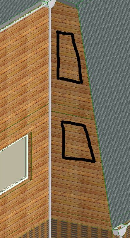

Window with sloping sides
I can not figure out how to create a window that has 4 sides, 2 of which that join at a right angle, but the other two slope downwards at different angles.
The roof pitch is 9⁰ and the sloping wall is 100⁰
See the attached picture, it's the timber clad wall with no windows on it at the moment. My aim is to create a window on the top story that follows the roof and sloping wall, and on the story a below that has all sides at right angles apart from one side that should be parallel to the sloping wall.
Thanks.

Create your slab around your window or door
and set listing & labeling ID set is name : WallHole
Is my picture
Sorry my english

Eddy, I hadn't heard of that trick.
You could also follow the last set of instructions to put the WallHole command in the 3D script. This way you could still use the ID for labeling later.
6. Now, if your window has a non-square WallHole, you will need to select the window and choose File/GDL Objects/Open Object. (Don’t be afraid! We just need to copy and paste some GDL here.)
7. Click on the 3D Script button.
8. Scroll down until you see the script that is the single slab that you used to make the glass. Select and Copy the script that starts with cPRISM_ "Glass", "Glass", "Glass" and ends with BODY -1. (Note, the data between is the coordinates we will be using for the WallHole).
9. Scroll down to the end of the script and paste. Delete the first pasted line that likely looks like:
10. In front of the next line type WALLHOLE. (This cuts the wall for the window.) Click the button Check Script.
11. Save the object and Rebuild.

I put the following at the bottom of the 3D script and when I check script it an error comes up saying there aren't enough parameters at line 118... and highlights where it says WALLHOLE
WALLHOLE
             5,          0.1,
        0.4457228563283, 1.49683505719,     15,
        -7.105427357601E-015, 1.56743062233,     15,
                   0,            0,     15,
        0.7096552625813,            0,     15,
        0.4457228563283, 1.49683505719,     -1
base
vert    -1.110223024625E-016,            0,          0.1
vert    1.56743062233, -5.551115123126E-017,          0.1
vert    -1.110223024625E-016, 0.7096552625813,          0.1
vert    -1.110223024625E-016,            0,          0.2
coor      8468,     -1,     -2,     -3,     -4
del          1
body    -1
The original section of the script is:
cprism_ "Glass-Clear", "Glass-Clear", "Glass-Clear",
             5,          0.1,
                   0,            0,     15,
base
del          1
body    -1

Thanks, this seems to have done the trick!
Nile,
Put the 'WALLHOLE' command on the same line as first parameters.
as in -
WALLHOLE              5,          0.1,
etc...
Peter wrote:
Nile,
as in -
WALLHOLE              5,          0.1,
etc...
Ah now it works cheers!
