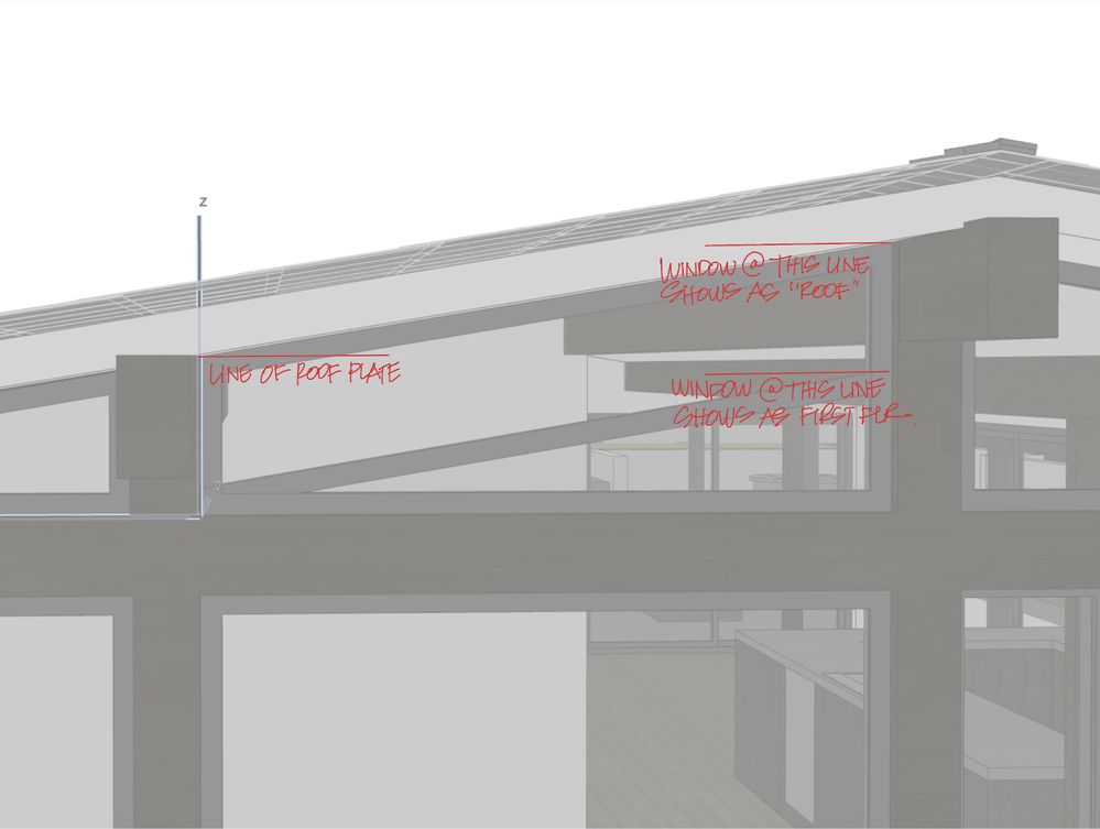

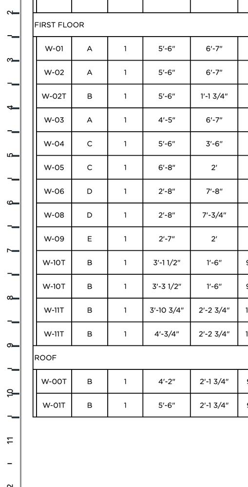

Ok, struggling to make my window schedule work, because it seems that my roof plate height is interfering with the designation of my window. Window is placed in a First Floor wall. Typically, that would place it as First Floor for my schedule. But if I raise the top of the widow above the line designated by "Roof", which is the plate, it changes the designation to being on the Roof level. How do I get this to resolve properly?
I have enclosed the schedule and a picture explaining the issue.

Change the floor plan display of the wall to cut only.

In actuality, the lower one is also above the plate line, so now I have NO idea why this is happening. It's driving me nuts.
formfireglass
Do we have anyone reading these? I'm still having to add 2 views of my schedules and fake it. What makes this happen?
I am not sure but, is it because your window anchor is 'header to storey' instead of 'sill to storey'?
I changed it from 'Sill to Wall Base' to 'Sill to Story', unfortunately no change. Another window (same sill height, but shorter overall) doesn't get moved to the roof. It's maddening.
formfireglass
That did it. How absolutely bizarre. Thank you!
