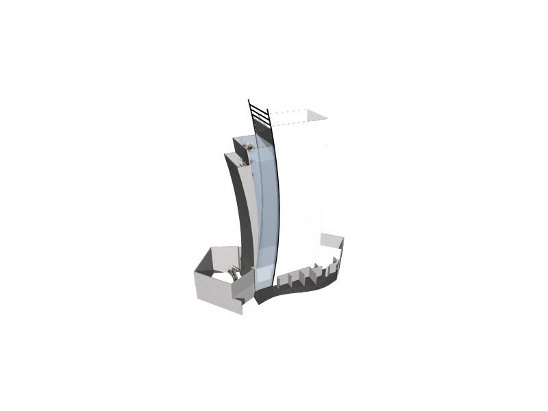

I draw a curved wall with complex profile,but I cant draw window in this wall what should I do?

I draw these walls with complex profile,I cant draw window at all,here is the pic

Your sketch is too complex for me to understand.
Pick just one complex profile wall as an example.
Post the profile shape.
Then we will see.

here is my wall that I darw it with complex profile,but I cant draw window for it plz help me
Dwight
Fine. There's your problem: you want to put a window in the END of the wall, not the FACE.
When you define the complex profile, you will define the end rather than the faces.
Figure out a way to make four faces for each shape. Then the windows will insert.
